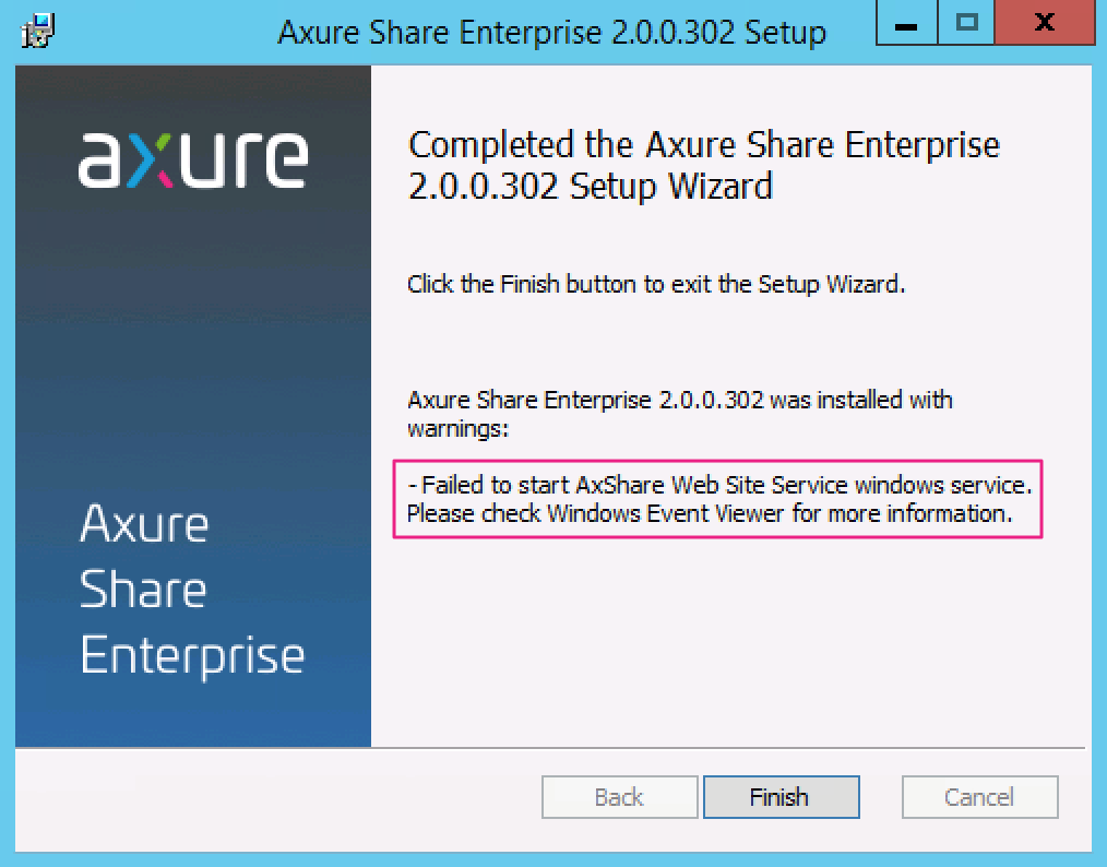

Failed to start AxShare Web Site Service Windows Service
The AxShare Web Site Service windows service for the Axure Cloud on-premises server will fail to start if another service is already running on port 80. The installer's final screen will alert you of this, as shown in the screenshot below.
You can also check for this issue by attempting to manually start the AxShare Web Site Service in the Services menu of the Windows Server Manager.
Solution
The surest way to resolve this issue is to uninstall IIS completely. (There is no need to reinstall Axure Cloud for Business.)
If this fails to resolve the issue, please email support@axure.com for help troubleshooting.
