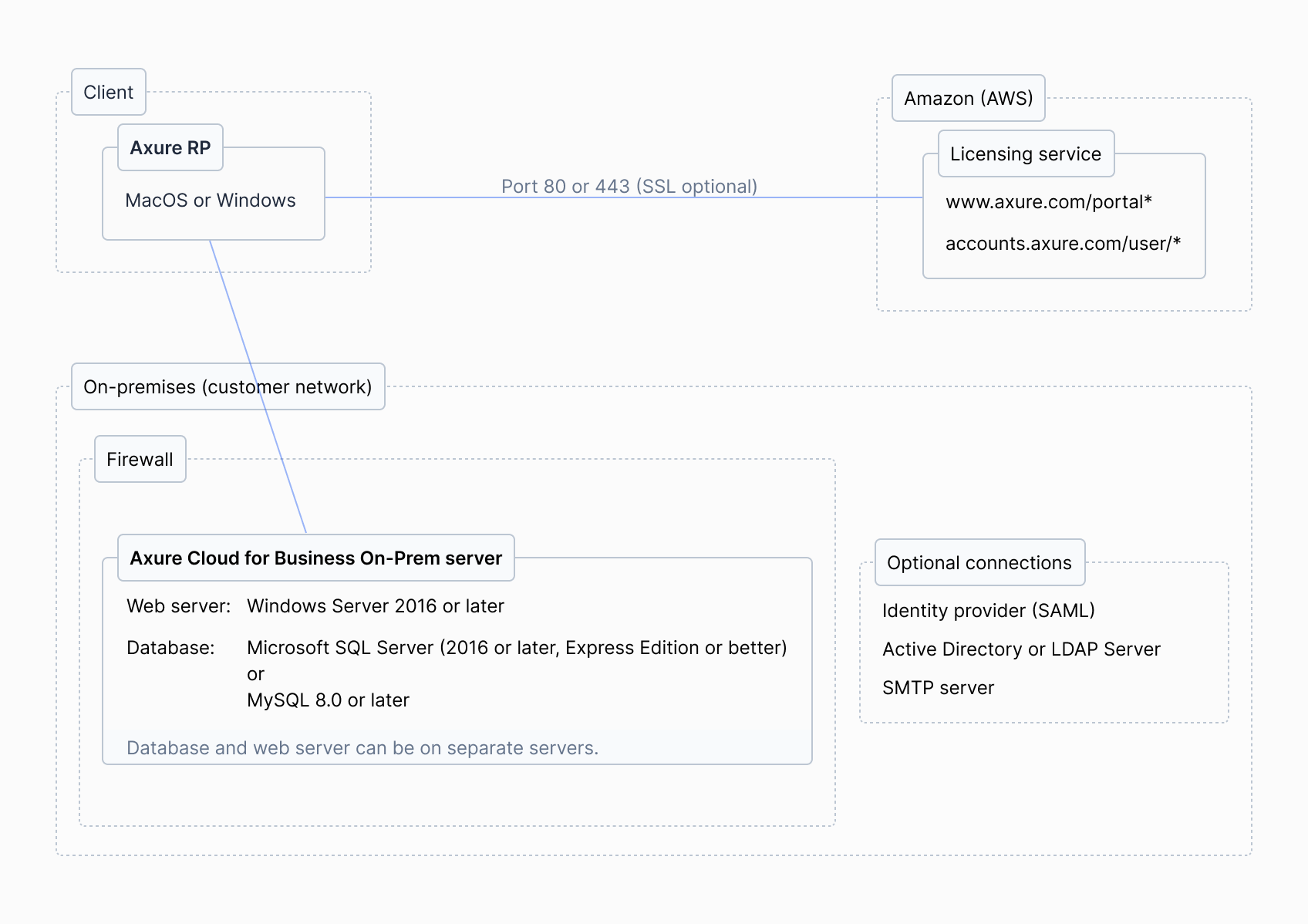

Axure Cloud for Business On-Premises requires both a web server and a database server. Installation steps must be performed for both servers. The installations can be performed simultaneously or separately (useful when there is a database administrator handling the provisioning and installation of the database and a separate system administrator).
By default, installation of the web service will walk you through setting up the database server, but it can also detect if the database server has already been set up.
Prerequisites
Web Server:
  • Windows Server 2008 R2 or later
  • .NET Framework 4.7.2
Database Server:
  • Microsoft SQL Server (2008 or later, Express Edition or better)
    • Should be installed with Mixed Mode authentication (aka "SQL Server and Windows Authentication mode")
  • MySQL 5.7 or later
Note: It is also possible to install the web server and the database server on the same machine.

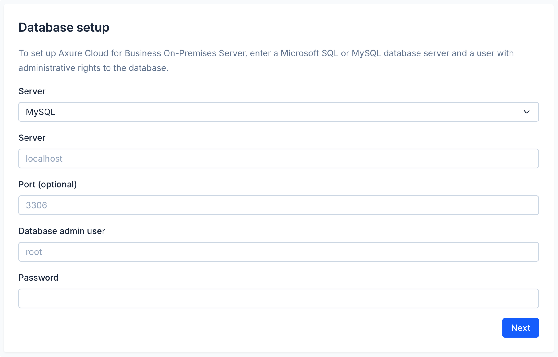

2. Database Setup
On the Database Setup screen, select either MySQL or SQL Server in the dropdown and provide the hostname and administrator credentials for your database server. (The admin user must have the necessary permissions to create tables and functions.)
The admin username is generally root for MySQL and sa for Microsoft SQL Server.
If you're installing with SQL Server Express, it's generally configured with an instance name (defaulted to SQLExpress), which can be specified with \SQLExpress appended to the host name: [hostname]\SQLExpress
Note: It is required that you install SQL Server with mixed mode authentication ("SQL Server and Windows Authentication mode").

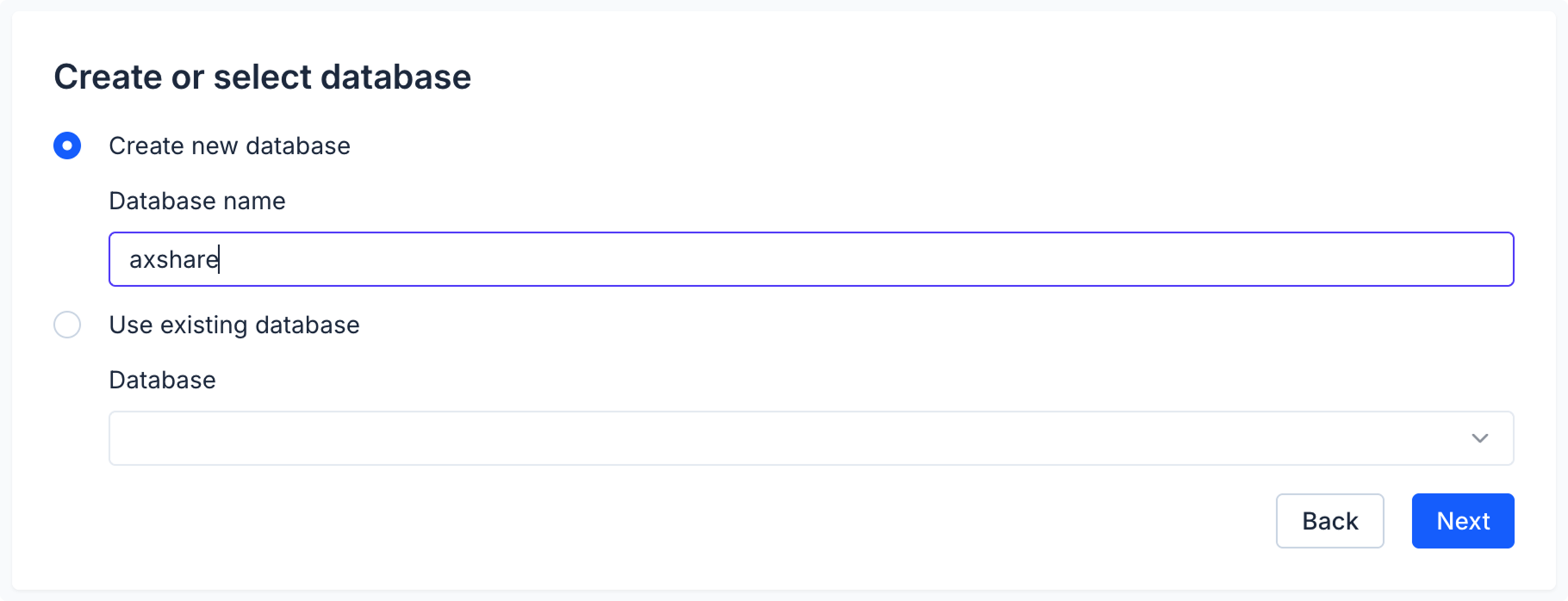

3. Create or Select Database
On the Create or Select Database screen, choose one of the following:
  • If you have not already created an Axure Cloud database on your database server, leave Create New Database selected.
  • If you have previously created an Axure Cloud database on your database server and would like to use it for this installation, select Use Existing Database and select from your available databases in the dropdown.

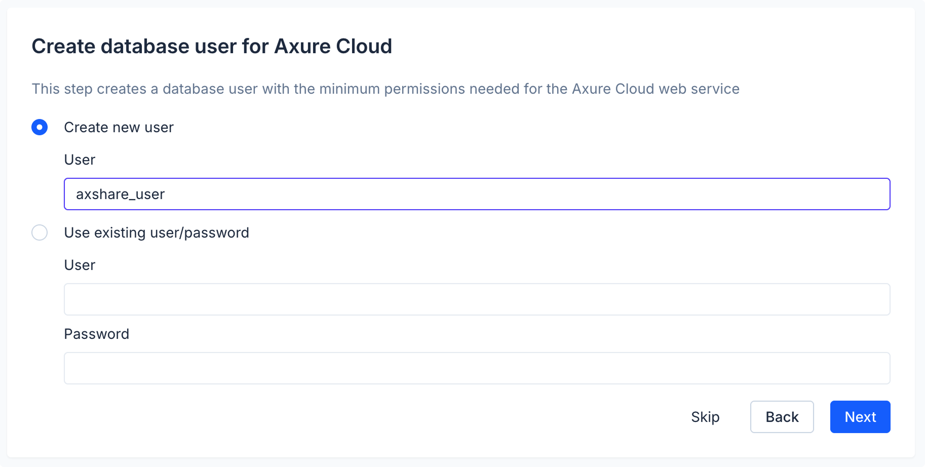

4. Create Database User for Axure Cloud
On the Create Database User for Axure Cloud screen, choose one of the following:
  • Select Create New User to create a new database user with the minimum permissions needed for the Axure Cloud web service. (You'll need this option if you created a new database in the previous step.)
  • You may select Use Existing User/Password if you chose to connect to an existing database in the previous step. Alternatively, you may create a new user for the existing database if desired.

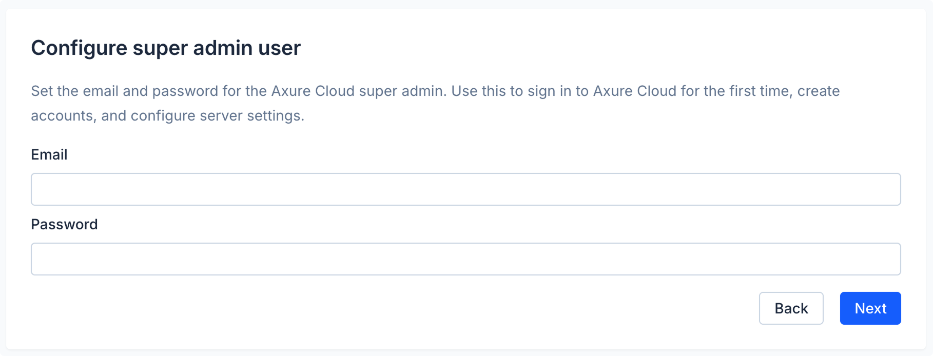

5. Configure Administrative User
On the Configure Administrative User screen, create a system administrator account for the Axure Cloud server. You will use this account to manage user access to your Axure Cloud for Business On-Premises server.

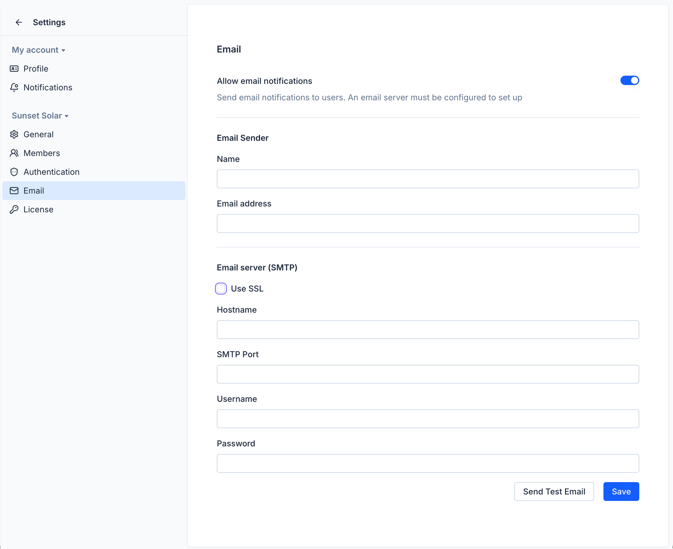

Email Setup
Axure Cloud users may request email notifications on their projects, and they can request a password reset email if they forget their password. In order for these services to work in your on-premises installation of Axure Cloud for Business, you'll need to provide the Axure Cloud server an email address it can use to send emails. We recommend doing so.
  1. Log in to the Axure Cloud server's web interface in your browser and click Admin Settings at the bottom-left.
  2. Switch to the Email tab and check the box for Enable Sending of Notification Emails.
  3. Fill out the form below and click Save.
