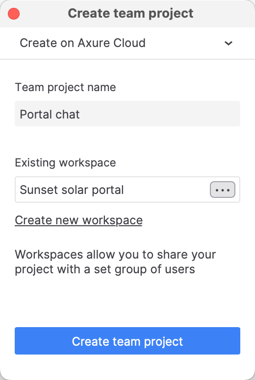

In the Create team project dialog, give the project a name.
Create a new workspace for the project or choose from your existing workspaces.
Click Create team project.

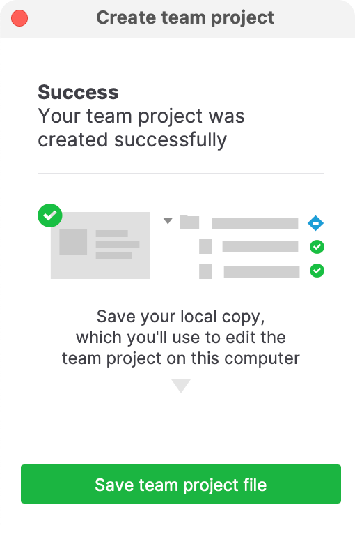

- Once the project's directory has been successfully created on Axure Cloud, click Save team project file to save your local copy of the project.

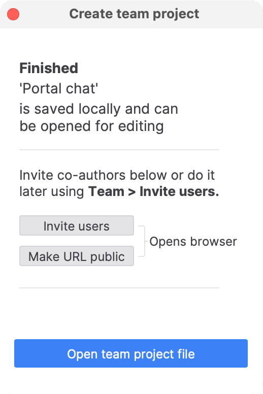

At this point, you have a few options for how to proceed:
Open your local team project file to begin working
Click Invite users to add collaborators to the project. (You can access this option later as well by going to Team → Invite users)
Collaborators can download their own local copies of the team project via Team → Get and open team project after accepting your invitation on Axure Cloud
Click Make URL public to generate a link that anyone with the link can access. By default, only workspace members can view the project’s HTML on Axure Cloud
You can change this selection later in the project’s overview on Axure Cloud. (More on this option in the Axure RP Projects on Axure Cloud article)

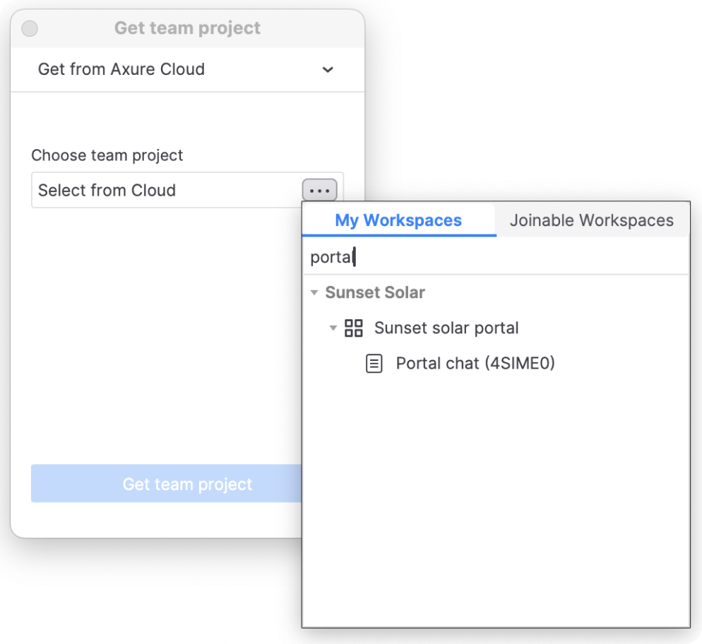

In Axure RP, go to Team → Get and open team project.
In the Get team project dialog, click the ellipsis menu and select the desired team project in the list that appears.
tipUse the search field at the top of the menu to search for the team project by name or ID.
Click Get team project. Once the project has been downloaded, click Save team project file to save your local copy of the project.
