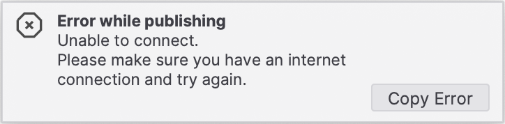

There are a number of actions in Axure RP that require a connection to the Axure Cloud servers: signing in to your Axure account, publishing a prototype to Axure Cloud, and any actions related to team projects. If Axure RP is unable to communicate with the Axure Cloud servers while attempting one of these, you'll see this error message:
Unable to connect. Please make sure you have an internet connection and try again.
This could be caused by something as straightforward as an interruption in your internet connection, or it could be caused by a network security mechanism blocking Axure RP or the domains it's trying to access. The troubleshooting steps below address the most common causes of this error.

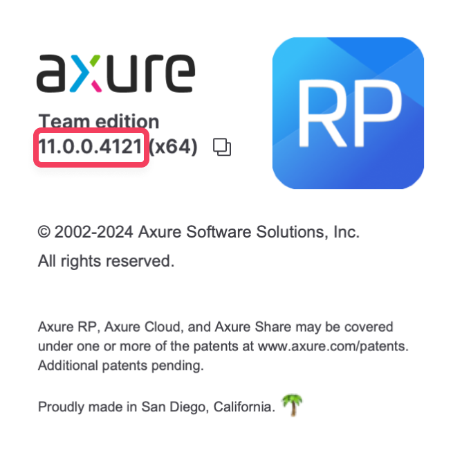

Update Axure RP
Ensure that Axure RP is up to date. To do this, compare the version number listed at Help → About Axure RP with the current version number listed on our website at www.axure.com/release-history.
Once Axure RP is able to communicate with our servers, you can use the Help → Check for Updates dialog instead.
If you aren't running the most recent version, download and install it. Then, try publishing your file or logging in to your account again.
