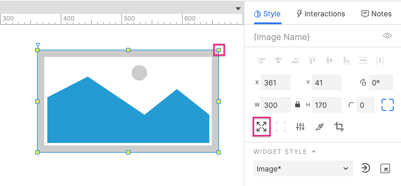

When you load an image, the image widget will automatically resize to the original size of the image being imported. To prevent the image widget from resizing, select it and double-click one of its resize handles before importing an image file. The resize handles will change from yellow to white, which indicates that the Fit to Image feature has been toggled off.
toggling Fit to Image on image widgets
You can enable auto-fit again at any time by double-clicking a resize handle or clicking the Fit to image icon in the Style pane.

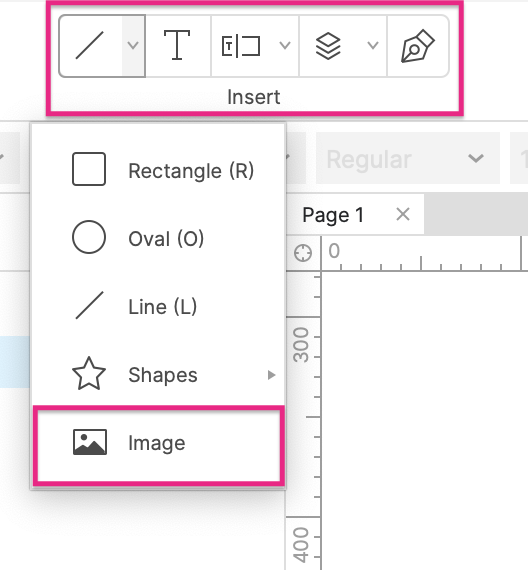

Click the Insert menu at the top-left of the interface and select Image to browse for an image file in your computer's file browser. The selected image will be inserted into your design at the center of the canvas.

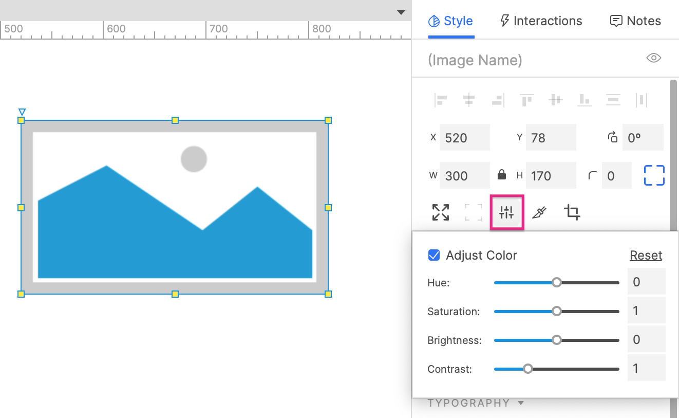

You can adjust the color of images via the Color Adjust menu in the top section of the Style pane. Check the Adjust color box and then use the sliders or the number fields below to change the image's hue, saturation, brightness, and contrast.
Click Reset to set the fields back to their default values, or uncheck Adjust color to toggle the image back to its default levels without affecting your selection for each attribute.

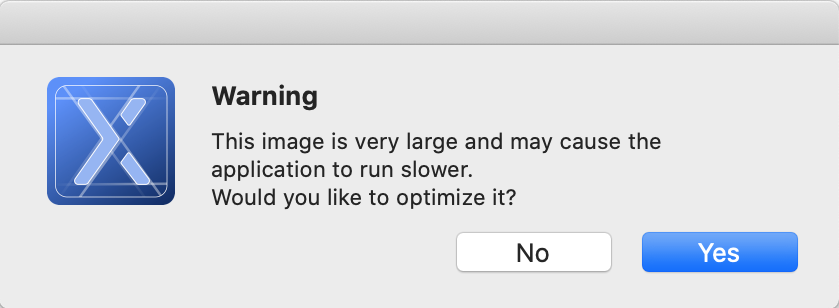

Large images can increase the size of your RP file and affect performance within Axure RP and in the web browser. Optimizing an image will decrease its file size and thus the size of the RP file. As a result, however, the image's quality may be decreased.
When you import a large image into Axure RP, you'll be asked whether or not you want to optimize it. You can also optimize images already in the RP file by right-clicking and selecting Transform image → Optimize image in the context menu.
