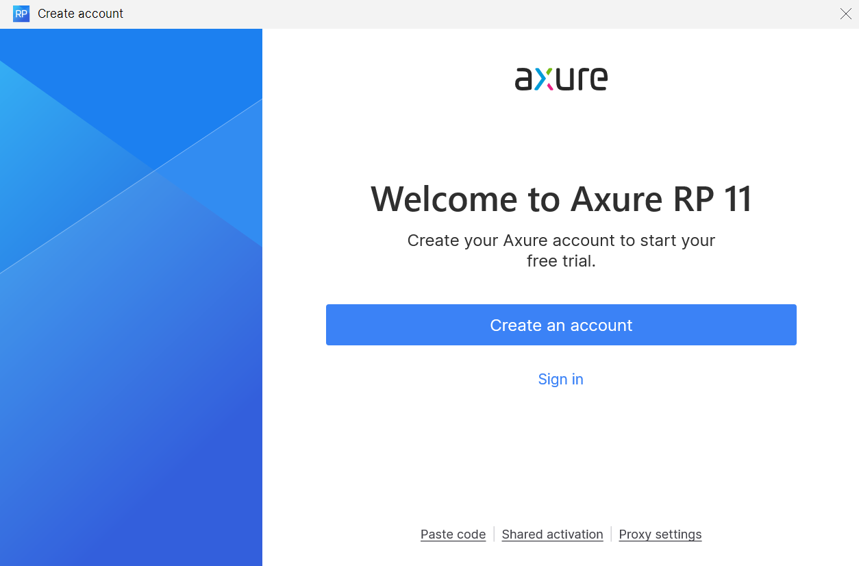

Launch Axure RP.
If you don’t have an Axure account yet, select Create an account and sign up using the email address that your subscription is assigned to.
If you already have an account, select Sign In.
- Axure RP will open your web browser to sign in. Once the authentication process is complete, you can navigate back to the Axure RP application and select Continue to RP to begin prototyping.

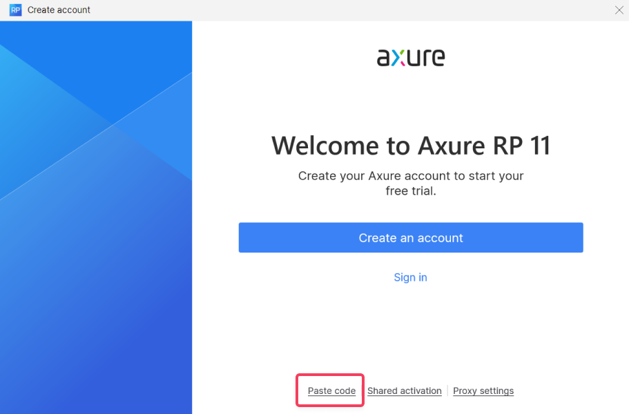

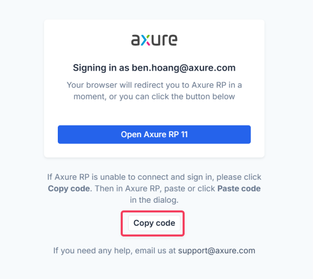

If Axure RP is unable to connect and verify your subscription after you sign in through your web browser, then use the steps below to activate Axure RP:
Select the Copy Code button in the authentication dialog in your web browser.
Navigate back to Axure RP, and select Paste Code at the bottom of the manage license dialog.
