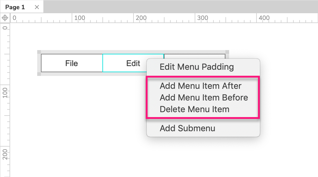

The classic menu widgets start with three top-level menu items. To add additional menu items, right-click an existing option and choose either Add menu item after or Add menu item before. To remove an option, right-click it and choose Delete menu item.

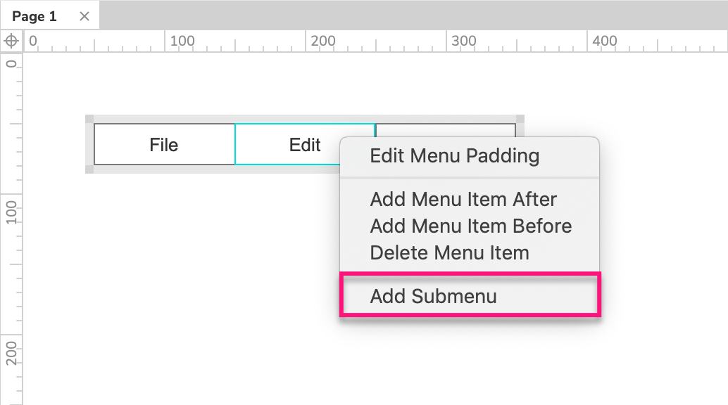

By default, the classic menu does not have any submenus. You can add submenus to any menu item (including items in submenus) by right-clicking the item and choosing Add submenu. Three submenu items will be added, and you can add and remove items per the instructions in the previous section.
To remove a submenu, right-click its parent menu item and select Delete submenu.

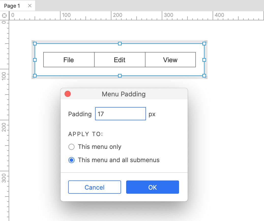

You can add padding around menu and submenu items by right-clicking an item and selecting Edit menu padding. This will push the menu's borders out away from the items, making the menu widget's fill color and border distinguishable from those of its items.
