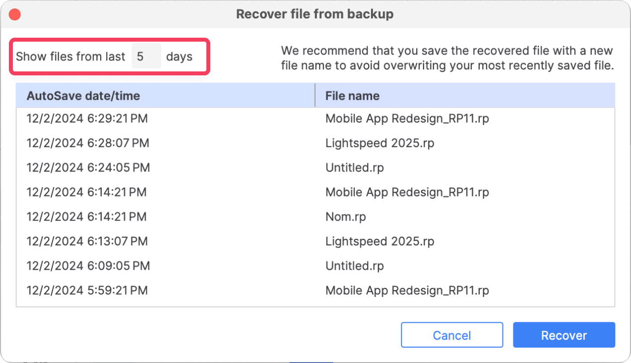

  1. Go to File → Recover file from backup. In the dialog that opens, you’ll see a list of the most recently saved backups.
  2. In the top-left corner of the dialog, enter a value from 1 to 30 to specify how many days of backups you want to see. By default, you're shown 5 days.
    Recover file from backup dialog
  3. Double-click one of the backup copies from the list to recover it. You will be prompted to save the file to your computer before you can open it.
