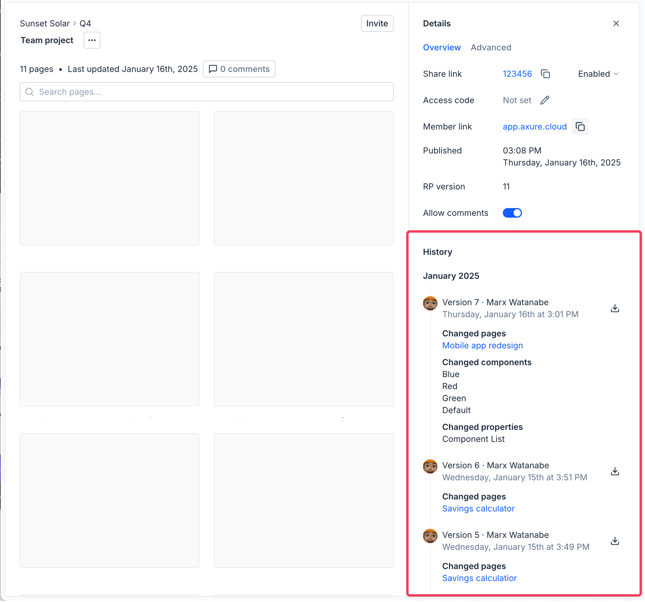

In Axure RP, go to Team → Browse team project history. This will open the team project's Overview page on app.axure.cloud in your web browser with the History listed in the right pane.
From Axure Cloud​
  1. Sign in to app.axure.cloud in your web browser or sign in to the Axure Cloud desktop app.
  2. Select the workspace the team project is located in and then click on the project's name.
  3. This will open the project's Overview page with the History listed in the right pane.
Revisions​
Team project revisions are organized into a feed with the following information about each revision:
  • The Revision's number
  • The email address of the User who checked in/sent the changes that created the revision
  • The revision's Check in notes, which list the assets that were changed along with any additional notes entered by the user who made the changes
  • The Date of the revision

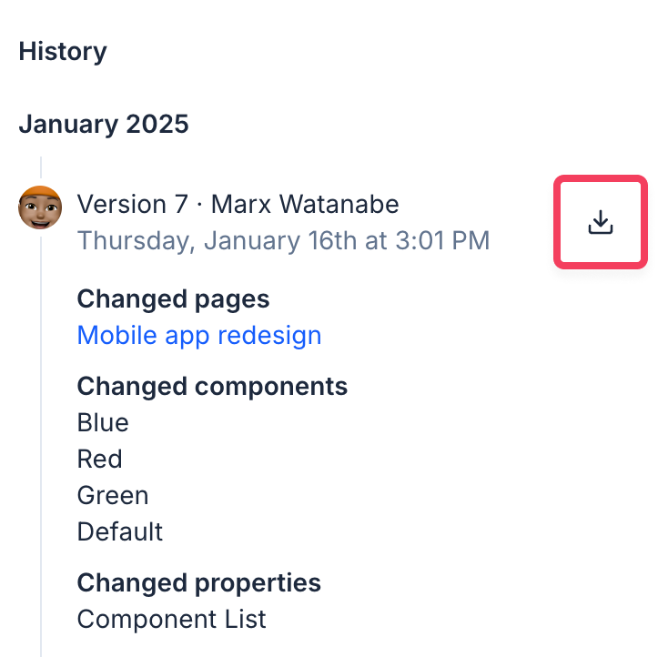

Downloading past revisions​
Click the download button to the right of a revision to download a standalone .rp file that contains a version of the team project as it was at the time the revision was created.
You can publish revision files to Axure Cloud to maintain a live version history of the team project that you can preview in your web browser, or you can use them to roll the team directory back to a past state.
