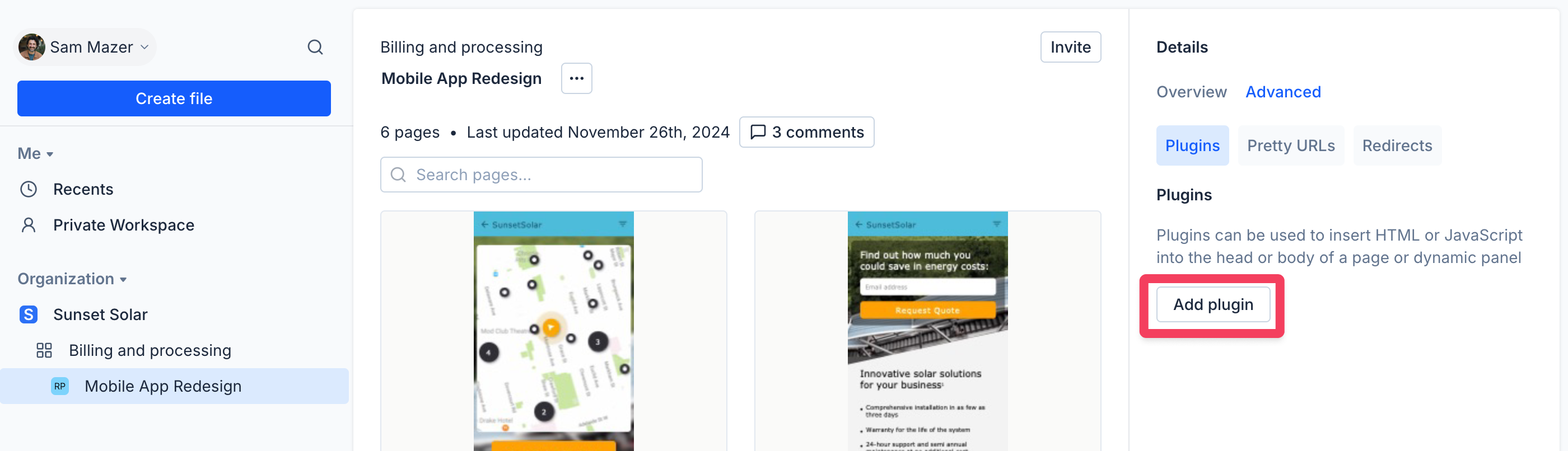

  2. Navigate to app.axure.cloud in your web browser or open the Axure Cloud desktop app and sign in.
  3. Click on your project's name to open its overview.
  4. In the details pane on the right, go to Advanced → Plugins.
  5. Click Add plugin.

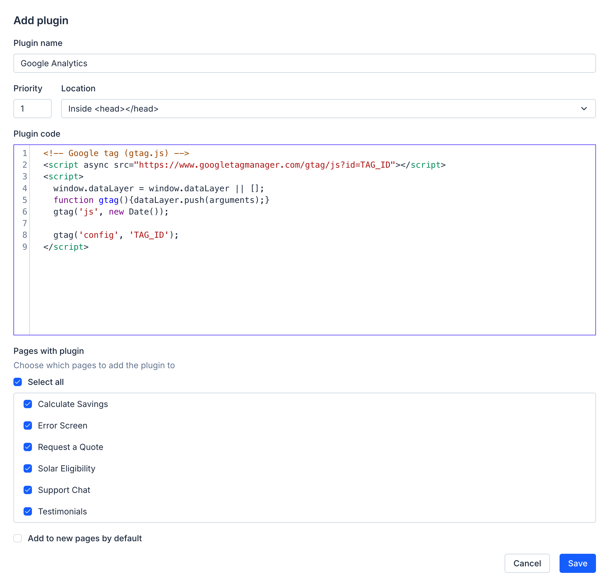

  6. Give the plugin a name, a loading priority (if the project has multiple plugins), and choose where you would like to insert the plugin's code:
    • inside the <head> tag
    • at the end of the <body> tag
    • inside a named dynamic panel you've created in the project's RP file.
  7. Enter your custom code into the text area.
    warning
    Axure Cloud plugins are inserted into project pages as raw HTML. As such, you must wrap JavaScript code in <script></script> and CSS code in <style></style> tags.
  8. Choose the pages you want to add the plugin to and click Save.

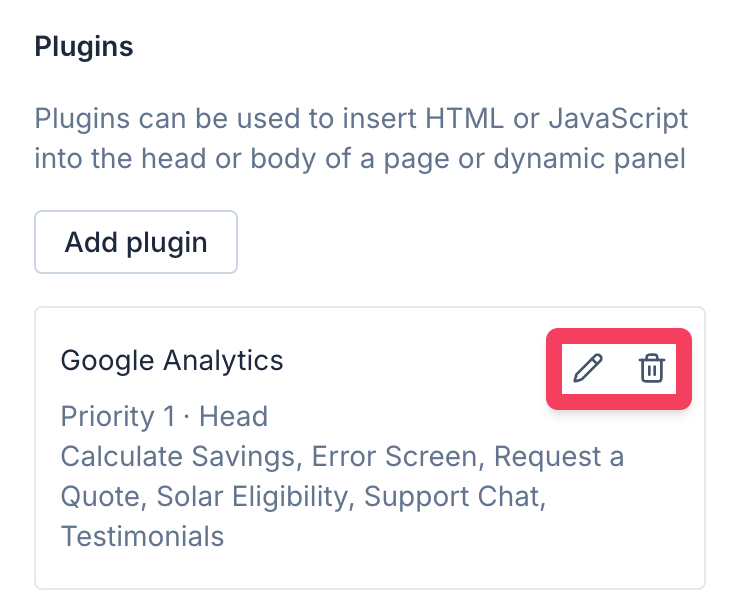

Editing plugins​
To edit a plugin's name, location, loading priority, or code, click the Edit button ✏️ of the plugin.
