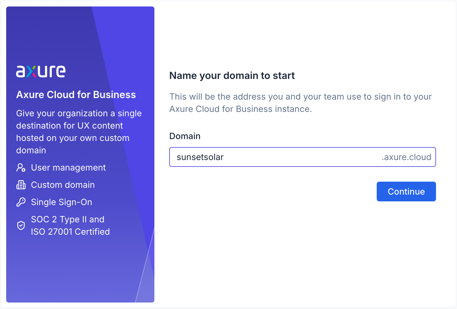

  1. Go to app.axure.cloud/app/asec/create and enter a custom domain name for your private instance. The instance will be accessible at [domain].axure.cloud.

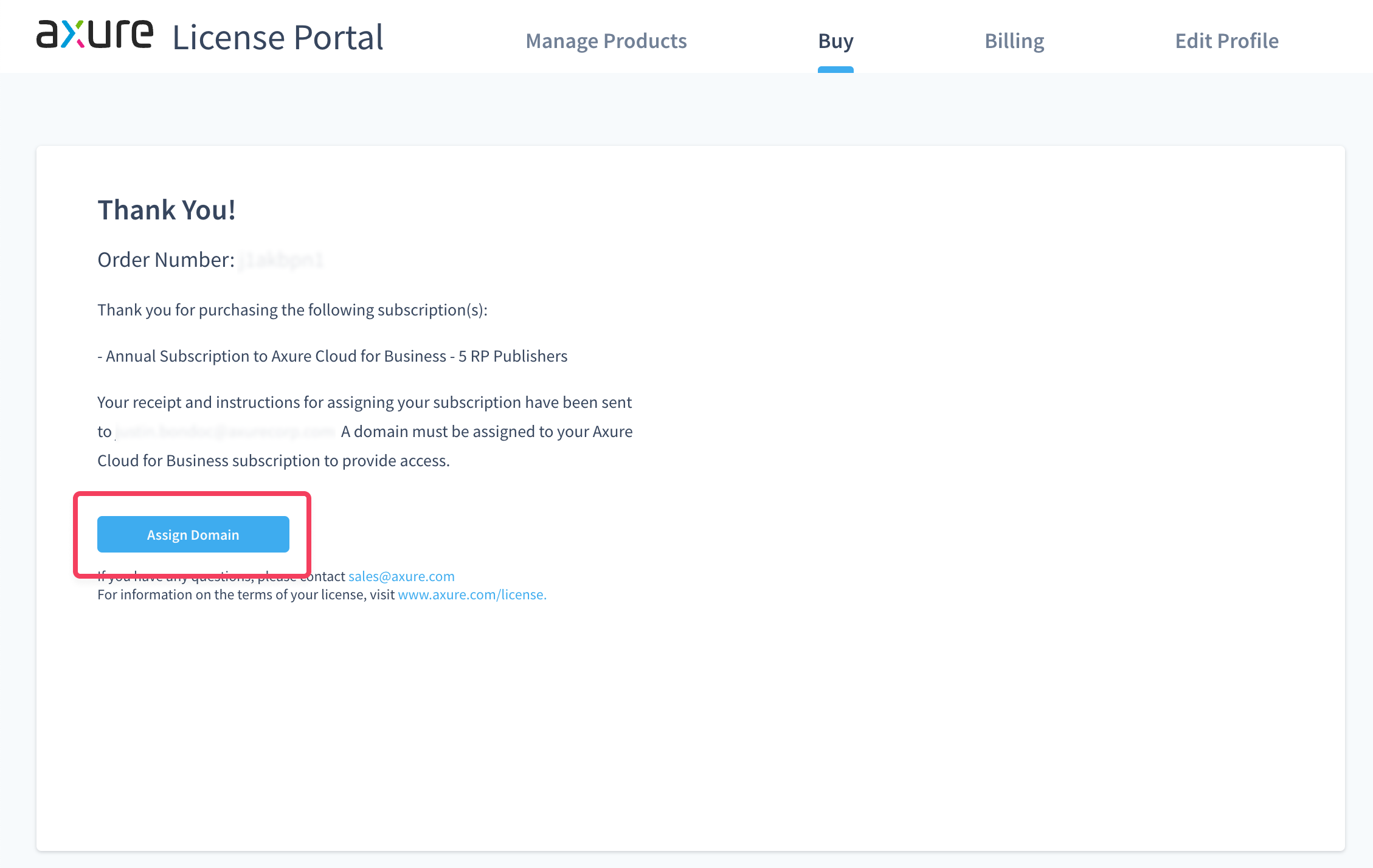

  3. On the purchase confirmation screen, click Assign Domain.
    You'll be taken to the Manage Products screen.

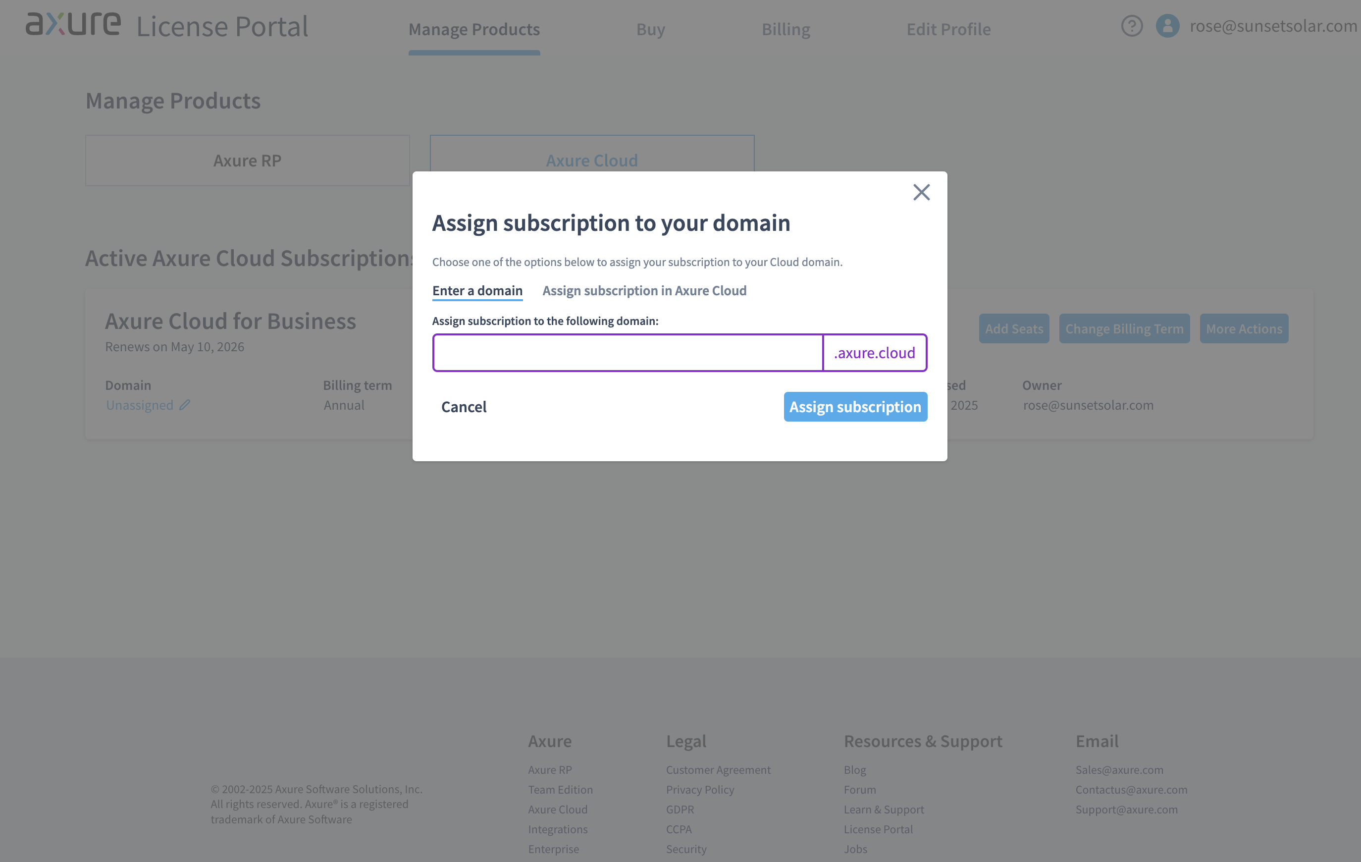

  4. In the text field that pops up, enter the domain you chose for the private instance in Step 1 of the previous section. Then click Save.
